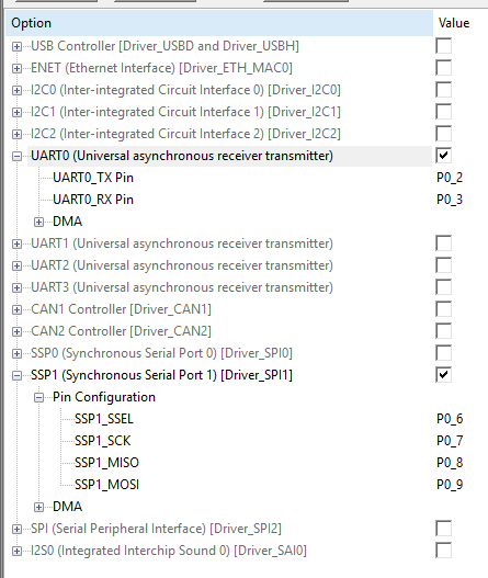

Hi, I'm trying to get SPI working on the LPC1769 using the CMSIS RTOS v2, and am having some issues.
I'm trying to send a 16-bit address (0x7FFE) over the MOSI line to query a register in a peripheral (code is attached). I set up the SPI pins in the RTOS configuration wizard as shown below:
The SSEL and SCK pins are outputting pulses correctly, but I'm getting nothing from the MOSI pin. And looking at the values set in the PINSEL0 register after initializing, the pins appear to be set to the correct SPI functions. Is there something I'm forgetting?

Hi, Graham,
I suppose that your code has issue:
while (1)        //main loop
            SPIdrv->Control(ARM_SPI_CONTROL_SS, ARM_SPI_SS_ACTIVE); //SS active
            SPIdrv->Send(&testdata_out, sizeof(testdata_out));            //Send data
            osThreadFlagsWait(0x01, NULL, osWaitForever);
            SPIdrv->Control(ARM_SPI_CONTROL_SS, ARM_SPI_SS_INACTIVE);    //SS inactive
            SPIdrv->Receive(&testdata_in, 1);                                                    //Receive data
Because you do not post the low level driver of SPI, I suppose that you set up the /SS pin as GPIO mode,  SPIdrv->Control(ARM_SPI_CONTROL_SS, ARM_SPI_SS_ACTIVE) function clears the GPIO,    SPIdrv->Control(ARM_SPI_CONTROL_SS, ARM_SPI_SS_INACTIVE) function set the GPIO.
I think setting/clearing the GPIO is okay.
But as you know that the SPI is a synchronous mode, in other words, when the transmitter has completed the transfer, the receiver has received the data at the same time.
so you code seems to be:
             SPIdrv->Receive(&testdata_in, 1);  ////Rong modified
            //deleting the following code
            //SPIdrv->Control(ARM_SPI_CONTROL_SS, ARM_SPI_SS_ACTIVE);        //SS active
           // SPIdrv->Receive(&testdata_in, 1);                                                    //Receive data
           // osThreadFlagsWait(0x01, NULL, osWaitForever);
            //SPIdrv->Control(ARM_SPI_CONTROL_SS, ARM_SPI_SS_INACTIVE); //SS inactive
