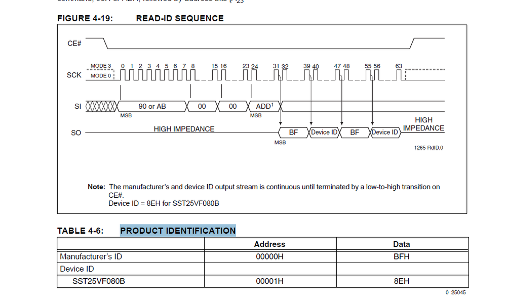

I'm trying to interface an SPI Flash memory from Microchip (SST25VF080B-50-4C; datasheet attached) using the SSP interface of the LPC1769 LPCXpresso board. I'm using the LPCOpen library. Initially I would like to issue simple blocking commands and get some fixed responses out of the chip. For instance issuing the JEDEC READ-ID command (0x9F; page 16) should return a fixed response of 3 bytes: [0xBF, 0x25, 0x8E]. However no matter what I do I'm getting [0xBE, 0x19, 0xF8]. Same thing happens with the Read Status Register command (0x05; page 14) which on powerup should return 0b00111000 (0x38); instead it returns 0b00011000 (0x18).

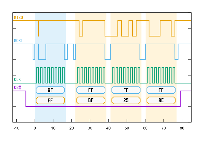

Setting the clock to 500 kHz seems to have helped. I've attached the trace (x-axis is time in us) from the JEDEC READ-ID command the chip responds with the correct set of bits. This has also been confirmed by the software. At 600 kHz the output is similar to what I've observed in the original post.
I've also checked the Read Status Register command (RDSR). On powerup the chip responds with 0b00011100 (0x1C) which seems correct according to page 5 of the manual. Upon issuing the Write Enable command (WREN) when reading the status register again the bit 1 (starting from 0) is flipped and RDSR returns (0b0001110). This seems consistent with what the manual indicates. So it seems that the 600 kHz was affecting the outputs. I need to investigate what's the case in higher clock frequencies.
3,550 Views
