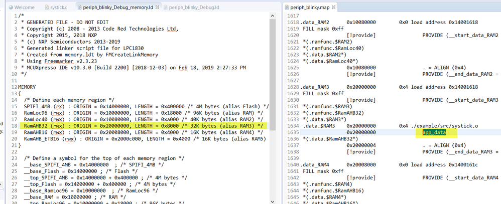

First of all , please use the latest version MCUXpresso IDE v10.3.MCUXpresso IDE|Eclipse-based Integrated Development Environment (IDE) | NXP
- I test on a LPCopen project, includes the header file cr_section_macros.h, then add app_data as your description:
#include <cr_section_macros.h>
_DATA(RAM3) uint32_t app_data;
After build , we can see this variate is placed in RamAHB32 section:

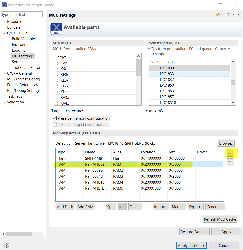

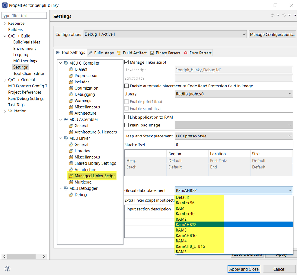

-If you want to put all global date into RamAHB32, there is a simple method, the Managed Linker Script
mechanism  allow the user to specify a specific memory region to be used for the global data:
- If you want to put all of the data into RamAHB32 ,  just config it as the first ram:
