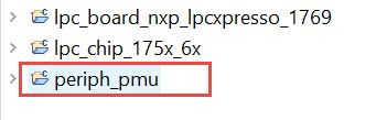

Hello @laurianussss
How about testing the low - power demo under LPCopen on your side first?
It uses timer as wake up source.
Alice
