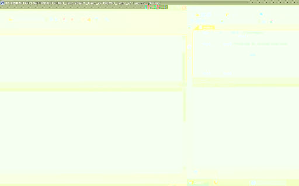

Hello everyone, I have figured out how to configure and initialize emWin (I put all the files. Hei various conf. C, use GUI_Init (), and I include the file guirv. H that interests me). I had some conflict with conf custom gamma correction and then I deleted them and I do not have that kind of mistake. But those are still in the picture as I clear?
