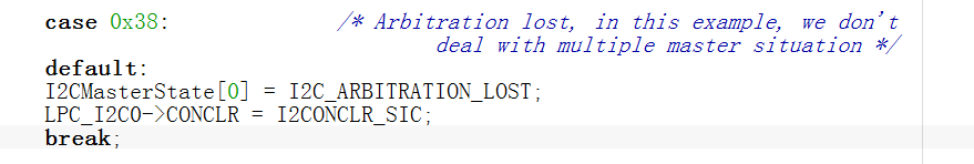

There is one thing that I noticed. By setting some breakpoints in i2c.c file in I2C0_IRQHandler() routine I found out it goes to this case after sending the first byte :
     case 0x38:          /* Arbitration lost, in this example, we don't deal with multiple master situation */
     default:
     I2CMasterState[0] = I2C_ARBITRATION_LOST;
     LPC_I2C0->CONCLR = I2CONCLR_SIC;
     break;

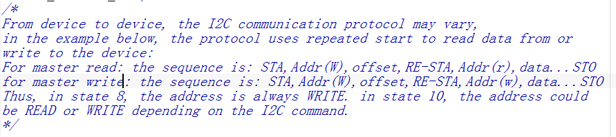

If I understand the state machine implementation in the code bundle driver correctly, then a small modification to your get_time() function is necessary.
The first address byte must be a write address, and the read address must be added as a third byte in the MasterBuffer. The driver appears to use that third byte when it reaches state 0x10 (after the repeated start).
  1. I2CWriteLength[PORT_USED]=2;
  2. I2CReadLength[PORT_USED]=3;
  3. I2CMasterBuffer[PORT_USED][0]=DS3231_ADDR_WRITE;//0xD0
  4. I2CMasterBuffer[PORT_USED][1]=0x00;
  5. I2CMasterBuffer[PORT_USED][2]=DS3231_ADDR_READ;//0xD1
  6. state=I2CEngine(PORT_USED);

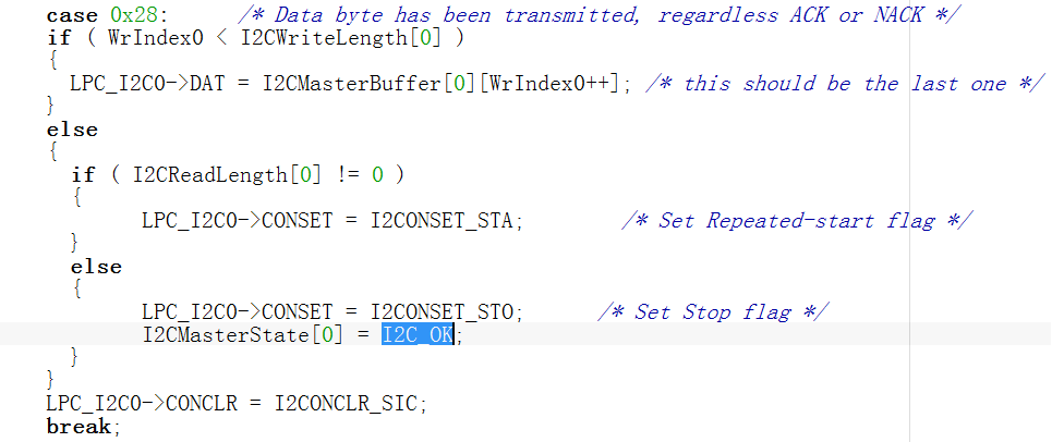

Cause when I first call rtc_set_time() the state reaches to I2C_OK in 0x28 and I think it's fine :
But after this when I call rtc_get_time() it keeps going to the I2C_ARBITRATION_LOST state in case 0x38 or default case except the first time after writing the first byte into I2CDAT register (case 0x08) : Why this keeps happening?
Why do you think about these lines that has been written in the i2c.c driver file ?
