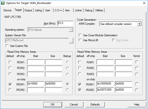

I'm using Keil and I mapped the application to the 0x10000 base address:
Can you clarify what you mean with the below sentence:
"The interrupt vectors need to be remapped for the user application before interrupts are enabled within the user application. For example, write 0x10000 to the vector table offset register (VTOR) to assign the new vector table location, then you can allow interrupts within the user application."
thanks in advance
Gabriele

Each application (bootloader and user) has its own set of interrupt vectors. From what I gather, the bootloader vectors at placed at 0x0 (the default) and the user app vectors are at 0x10000. When an interrupt occurs, the MCU uses the vectors that are located at the address specified by the VTOR register. When switching applications, the VTOR register must be updated accordingly.
Basically, I was saying be careful with interrupts during the switch, as immediately after execution jumps to 0x10000, if an interrupt occurs, it will execute the bootloader interrupt handler function (instead of the user interrupt handlers) until the VTOR register is written with 0x10000. This could be bad if it is occurring after execution has switched to the user app. This may not be your issue, but it is something to make sure is right.
In my apps, I disable interrupts, then jump, then update VTOR, then enable interrupts. Actually for the LPC176x, I do an MCU reset when switching applications so that all peripherals are in their default state prior to launching the app. I have included a link below to an archive of a version of my own firmware that includes a secondary USB bootloader. Look at the project USB-Boot and USB-Runtime within the 'Keil/LPC1769-LPCX' directory for reference.
