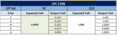

      We are working on DAC (P0_26), while configuration we set the value of 31. As a 10bit DAC, 0.10 V is expected but as per the datasheet ±10mV tolerance is acceptable.
     In all our customized board, output of the PIN is 0.11 V but in one board we get as 0.05V it reduces halfly. Kindly resolve this issue and navigate us to get rid from this
17,199件の閲覧回数
Dhaya
Here the verification is done on 5 different controllers and output taken on DAC pin

Dhaya
Yes, We verified in 2 controller board. In one board it shows 0.05V and on another it shows 0.10V (expected volt). While change the new controller in problem board, it works well as expected value.
Now we trying to use that incorrect controller in another board.
Note : Conversion error % is app. 50%. But while configure value of 313, it reaches nearly 0.98 V instead of 1.00V

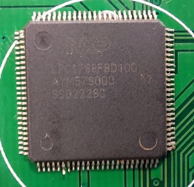

Dhaya
 Controller : LPC1768FBD100
     LOT & ID : AYM579000
                       SSD22290
Imported from : Widekey International Ltd
17,244件の閲覧回数
ZhangJennie
How is it if  use that incorrect controller in another board? we need to verify the probelm on part itself or PCB.
17,202件の閲覧回数
Dhaya
While change the defect controller part in other 2 PCB's, it react like same. (Output volt is 0.005 V instead of 0.10V)
17,175件の閲覧回数
ZhangJennie
it shows the problem is on chip itself.
I checked your vendor is not under the distributor list:
https://www.nxp.com/part/LPC1768FBD100#/
For NXP official distributor, you can apply to take failure analysis of the part.

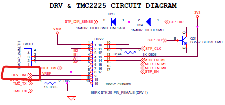

ZhangJennie
I suggest you test lpcopen dac demo code on your board to isolate the possibility of SW issue.
https://www.nxp.com/design/software/development-software/mcuxpresso-software-and-tools-/lpcopen-libr...
LPC1769 code also works on LPC1768
Please also post your DAC schematic. let me check.
I didn't find this company on nxp website distributor list. please let me know if I missed.

17,057件の閲覧回数
ZhangJennie
According to LPC176x datasheet DAC electrical characteristics, we need to connect load resistance at min 1K, and load capacitance about 200pf.
Please try this.

Dhaya
