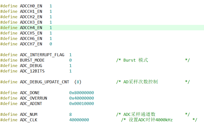

hi,i use the LPC1768 ,
when i use the ADC , i found a problem , i use all the 8 ch,
i use the same signal to test all the ch,
the ch0 ch1 ch2 ch3 ch5 ch6 is OK,but the ch4 have problem
it show
not a line ,and i use oscillscope  test  the  waveform ,it's ok ,not any problem.
this is my prj ,only the ch4 have problem !!!

#if ADCCH4_EN
LPC_PINCON->PINSEL3 &=~(0x03<<28); //P1.30AD0.4
LPC_PINCON->PINSEL3 |=0x03<<28;
LPC_GPIO1->FIODIR &=~(0x01<<30);//ADC0.4
#endif

ADCRead(4);
while(!ADCIntDone);
ADCIntDone = 0;
Ins_read = ADCValue[4];
Ins_read =Ins_read*1320/4095;
//ADCDataInput[4] =1200-Ins_read;
Ins_re =1200-Ins_read;
ADCDataInput[4] =(Ins_re+ADCDataInput[4]*7)/8;

jeremyzhou
Hi ,
the opportunity to serve you.
To provide the fastest possible support, I've attached an ADC demo project, please refer to it for details.
TIC
