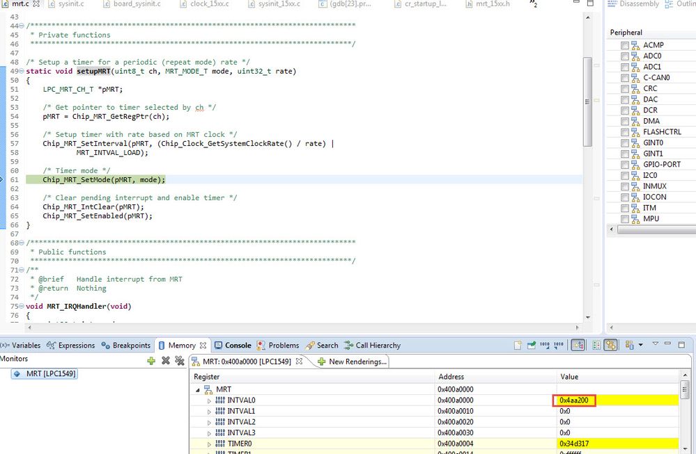

  • Are you sure that INTVAL register has a valid IVALUE? Remeber that MRT is a 24-bit timer, and, when you configure to get an interrupt every 1 seg, you configure IVALUE to be (72MHz / 1Hz = 72000000 or 0x44AA200), as you may see, 0x44AA200 cannot be set to MRT (it is a 28-bit value) so period for this timer is not the want that you desire:
So, you cannot get a 1 Hz frequency when MRT uses 72 MHz as its source frequency.
  • Taking in mind this previous point, you can use RIT period which is a 48-bit counter that is fed from Main Clock. It can provide a bigger period timer than Systcik and MRT (24-bit counters)
