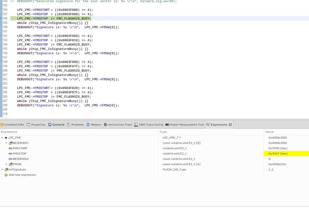

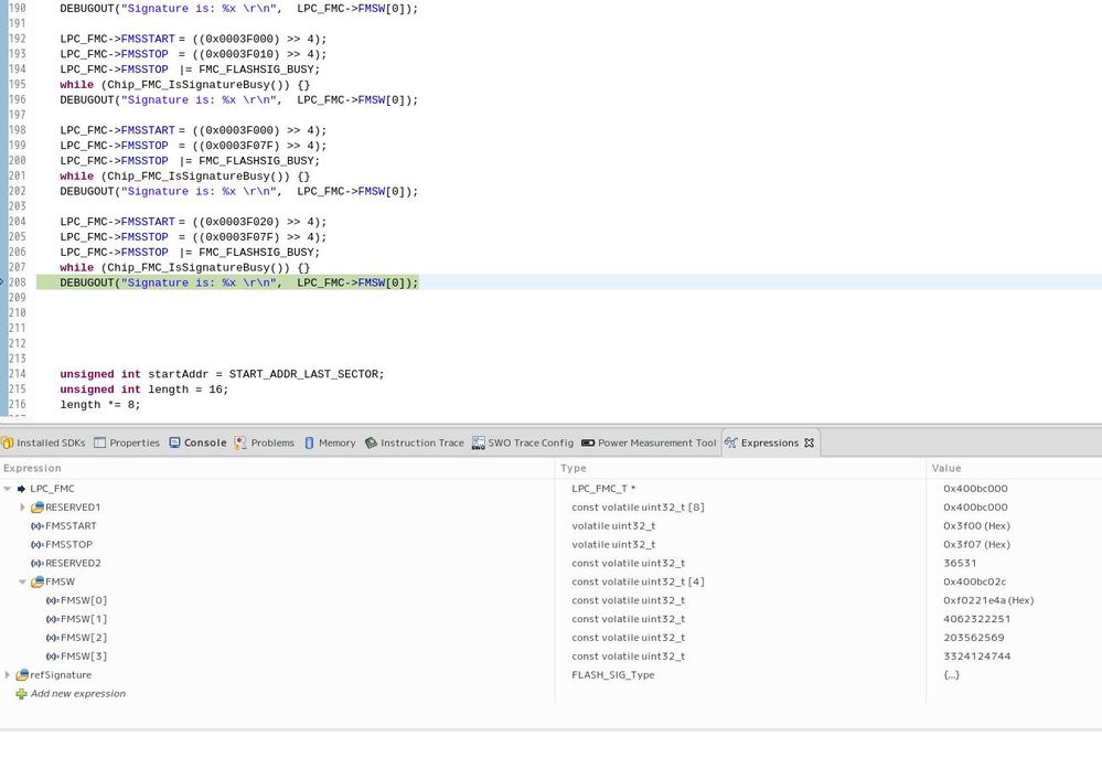

fukudatakuya
Thank you, Jeremyzhou.
I made  some test codes, and could get signature match!
You are correct.
But it is very hard to find and very strange behaviour.

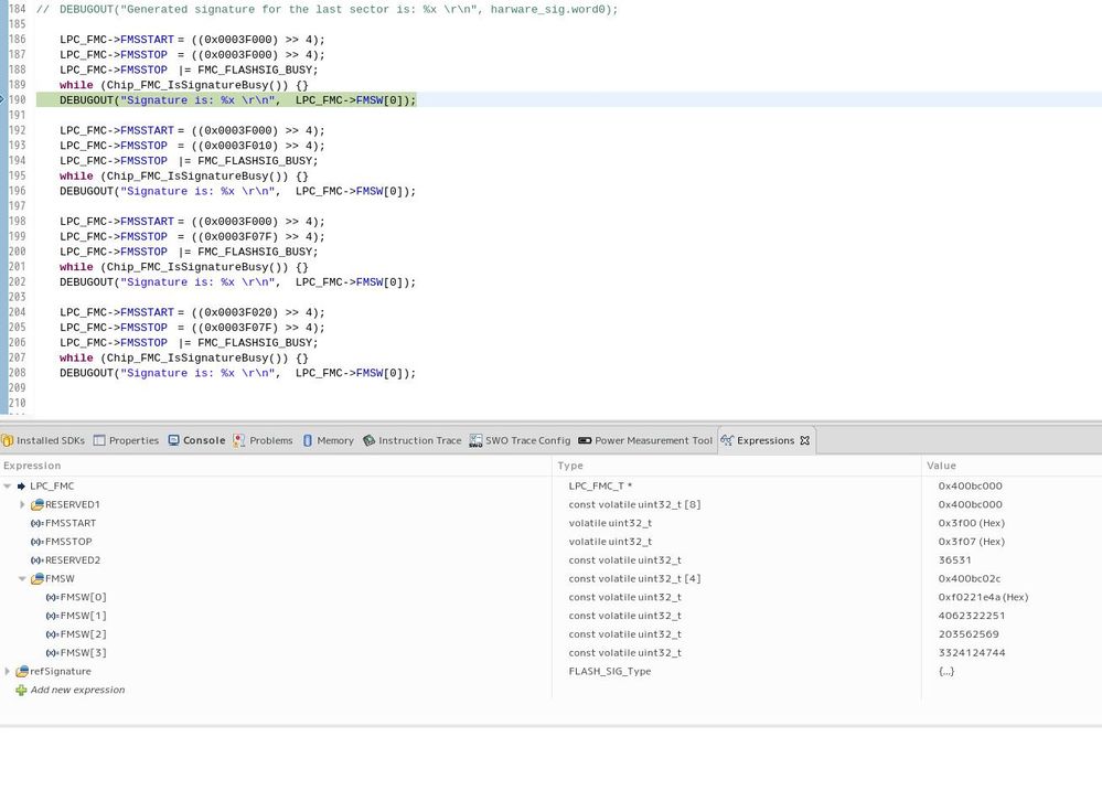

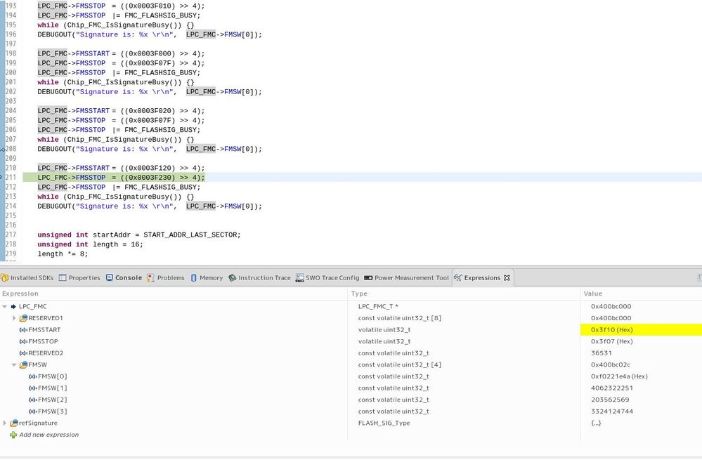

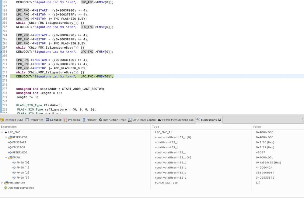

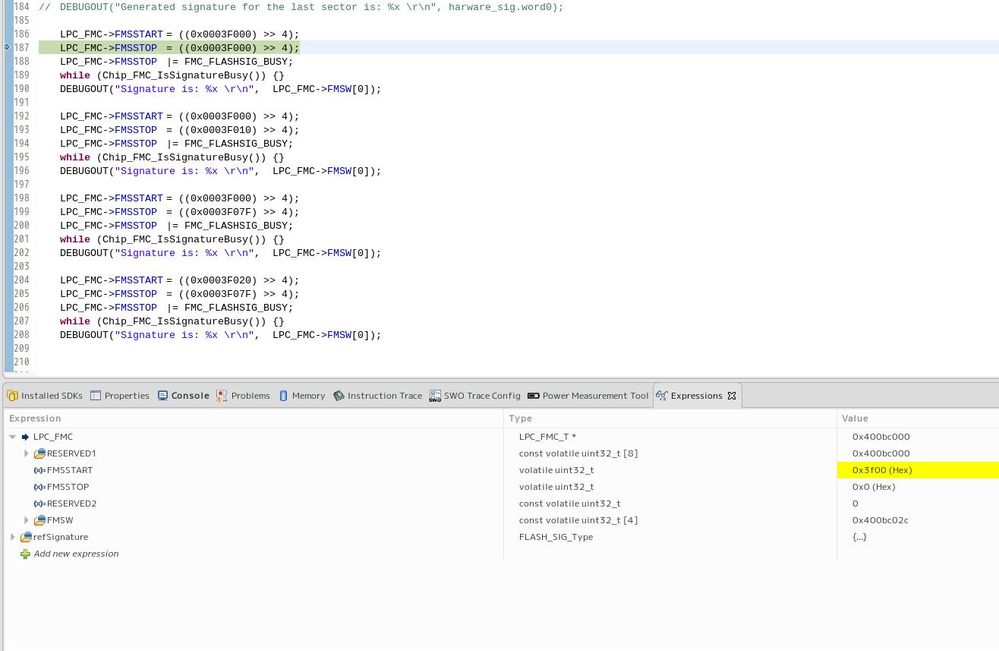

LPC1549 has 128-bit signature with algorithm as same as LPC Signature Generator | Mbed and LPC11U6X Flash Signature .
But specifiable start and end address are aligned 128 bytes boundaries for LPC1549.
If the specified start address is within the range from 0xXXXXXX00 to 0xXXXXXX7F, the address is changed to 0xXXXXXX00.
The start address range is within from 0xXXXXXX80 to 0xXXXXXXFF,  it is set to 0xXXXXXX80.
The end address is within the range from 0xXXXXXX00 to 0xXXXXXX7F, the address is changed to 0xXXXXXX7F.
The end address range is within from 0xXXXXXX80 to 0xXXXXXXFF,  it is set to 0xXXXXXXFF.
The signature is calculated within the changed address range (128 byte boundaries)
So we cannot calculate the exact target flash memory range.
This means that the result of below code is same.
    LPC_FMC->FMSSTART    = ((0x0003F000) >> 4);
    LPC_FMC->FMSSTOP     = ((0x0003F000) >> 4) | FMC_FLASHSIG_BUSY;
    while (Chip_FMC_IsSignatureBusy()) {}
    DEBUGOUT("Signature is: %x \r\n",     LPC_FMC->FMSW[0]);

fukudatakuya
Hi, jeremyzhou.
That is the point why I cannot match the result, exactly.
I attach MCUXpresso ide debug console pic.

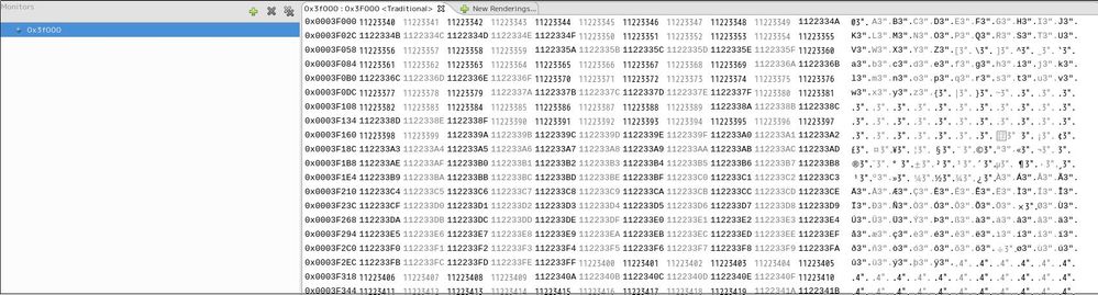

At first, I write sample data from 0x0003F000.
 Next, I set start address 0x0003F000.
And I set end address 0x0003F000( It's same as start address.), but not set STRTBIST bit yet.
So the end address is set to 0x0003F07X , aligned on 128 bytes automatically.
I set end address to 0x0003F010, but it set to 0x0003F07X automatically.
And the generated signature is same.
I set start address to 0x0003F020, but it set to 0x0003F000 automatically, and generated signature is same also.
At the last, start address to 0x0003F120, end address to 0x0003F230, but start is changed to 0x0003F100 and end is to 0x0003F27X automatically.
So I think the start and end address are aligned on 128 bytes boundary for LPC15XX.
