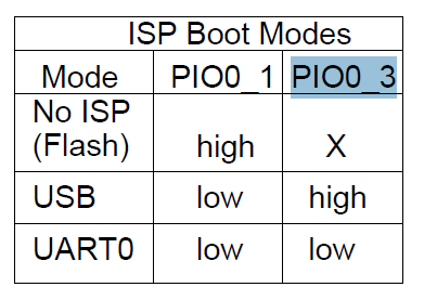

2. how to enter uart ISP mode
  Flow the following table, configure PIO0_1 and PIO0_3,then press reset button, the chip will enter the UART ISP mode, now you can use flash magic tool to download the code.
