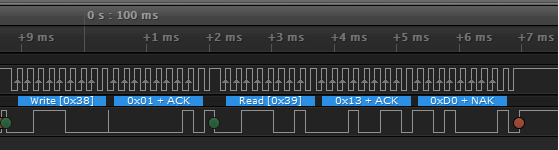

Attached image of datatransmission.

diggitallr
As a reply to my original question about the different states and catching the right statecode for next account.
I found an way where the code waits for SIC-bit, instead of explicit states.

The code works as intended. I got enough playing around with states. I got the sending states to work, but when it came to dealing with repeated start, write/read and ack/nack in same transmission, use of states came overwhelming.
I've attaached an image about the above transmission.

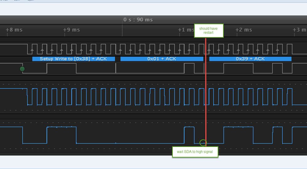

11,252 Views
diggitallr
Thank you for response. I've tested the code with added delay.

The delay didn' do the trick.
I have been reading the LPC11Uxx manual, the I2C section really closely to be precise.
The MMA8452 needs the following data sequence illustrated in the attached image. The initialization code works well and data transmission is correct.
I can't get an hold on about how the I2C bus actually works. I think i should change the operation mode to MASTER-RECEIVE from MASTER-TRANSMIT that is udes in the initialization of the accelerometer. The initialization is a set of binary instructions write to the various setup registry, that works and the accelerometer answers with ACK.
If I uncomment the STAT  != 0x10 condition, code stops running at that point. Clearly there is a problem with repeated start with my code.
The documentation gave me an expression that the status registry as instructive register, I've got that expression that the status flags must be correct for repeated start to occur. The communication must be controller with the status registry.
I can't understand how the communication should be done.

rolfmeeser
Make sure to never use read-modify-write with the CONSET Register. There are CONSET|= statements which should be plain assignments (CONSET=) instead.
Clearing SI bit must be the last action in each state. It's wrong to clear SI and clear STA afterwards. Change the order in which you clear the bits, or clear them simultaneously (CONCLR=SIC|STAC)
In state 0x28 you are almost there: CONSET=STA, CONCLR=SIC (missing...). This will bring you to state 0x10.
Once there, don't forget to clear both SI and STA after writing the read address to DAT.

kerryzhou
Hi Oscari,
  Because I don't have the MMA8452 accelerometer on my side, then I can't test it.
  But I think you can try to add a little delay follow 0X01+ACK

I have check your wave, it seems the I2C data signal didn't pullup in time, so please add the delay(5) check it again, whether the I2C_DAT can be pullup?
After add the delay, please give me your test wave, I need to analysis it.
