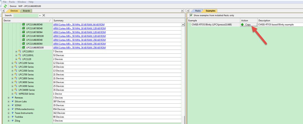

jeremyzhou
Hi Tom Gut,
I'd highly recommend you to refer to the demo which is provided from the Keil IDE, it can works well on the LPCXpressor11U68.
TIC
