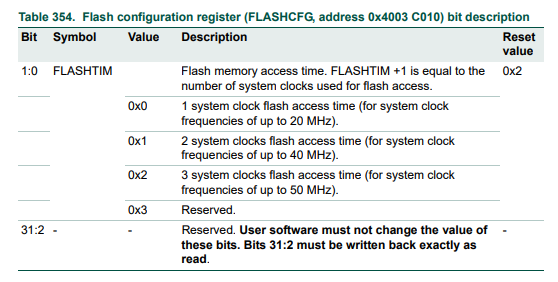

Is there any way by which the execution from the flash can be accelerated?
Yes, I recommend you to check the user manual (UM10732.pdf) chapter 25: Flash Controller. In the table 354 you will see that you can change flash memory access time.
You are running at 48MHz and it's taking 3 system clocks to access the flash. But if you slow down the system clock to 20MHz then you can set the FLASHTIM so it only takes 1 system clock to access the flash. Although the system clock will be running at a lower frequency, this will decrease the flash memory access time.

shashank_garg
I am using the LPC 84x. I also want to confirm the same technical query. IN LPC 84x there is no such frequency depend wait cycle. Here in reference manual, the flash access time is:
As compared to LC11x, here in user manual, there is no wait cycle depend on frequency. Please confirm that whether I can have 1 system clock flash access time independent of frequency.
3,760 Views
victorjimenez
Hello Shashank Garg,
In the user manual section 6.4.1 before the table you posted you will find the following information:
Access time to the flash memory can be configured independently of the system frequency by writing to the FLASHCFG register.
Victor.

chrispflieger
That won't actually make the access time too much faster. 2 cycles @ 40 MHz == 1 cycle @ 20 MHz.
As to the original question - the chip is as fast as it goes... get a faster chip if you need a faster chip (e.g. LPC15xx).
I'm not sure what you're trying to do, but running anything more than a small bit of code from SRAM is going to be a lot of work, since the code will likely have to be position independent (PIC). Plus, I think PIC tends to run slower because of all the addressing issues.
