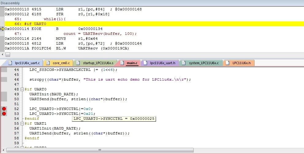

I'm having a weird problem with using the synchronous mode on the USART0 peripheral.
I need to receive a bit stream sampled on the rising edge of a clock with no end or start bits, but attempting to set both of these parameters sets the sampling bit to falling. I can do rising with end and start or falling and no end and start but not both rising and no end and start. I can't even change it using the memory inspector in LPCXpresso.
For clarity, the syncctrl register  goes to 0x25 when I try to set it to 0x21.
This is the exact configuration I'm using
Chip_UART0_Init(LPC_USART0);
Chip_Clock_EnablePeriphClock(SYSCTL_CLOCK_UART0);
LPC_USART0->SYNCCTRL|=UART0_SYNCCTRL_SYNC|UART0_SYNCCTRL_STARTSTOPDISABLE; // Enable sync mode
Chip_UART0_SetupFIFOS(LPC_USART0,UART0_FCR_FIFO_EN); //Enable Input FIFO
Chip_IOCON_PinMuxSet(LPC_IOCON, 0, 17,(IOCON_FUNC3 | IOCON_MODE_INACT));
Chip_IOCON_PinMuxSet(LPC_IOCON, 0, 18,(IOCON_FUNC1 | IOCON_MODE_INACT));
How do I get around this issue, or is this some weird limitation of the chip?

Dezheng_Tang
UM mentioned:
Data changes on TxD from falling edges on SCLK. When SSDIS is 0, the FES bit controls
whether the USART0 samples serial data on RxD on rising edges or falling edges on
SCLK. When SSDIS is 1, the USART0 ignores FES and always samples RxD on falling
edges on SCLK.

zeph
This doesn't fix my problem. The code you sent has the same problem.

jeremyzhou
Hi Nicholas Hunn,
Thanks for your reply.
I've also replicated the issue, and I will contact with AE team for checking.
