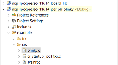

I try to do simple led blink using LPC11u35 dip module. I use LPC-Link2 and connect to swd pins on LPC11u35 to program the flash.
Below is the change to system_LPCUUxx.c that I've made to use the internal clock of the chip;

Hello ahmad_,
Recommend you can refer to the blinky demo under LPCopen for LPC11U14:
Download from:
https://www.nxp.com/design/microcontrollers-developer-resources/lpcopen-libraries-and-examples/lpcop...
