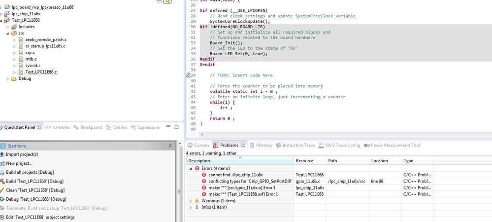

I am using LPCXpresso IDE and LPCopen 2.12 11E68 example projects.
I have met build errors with all projects.
 I am seeking help for what is the reason of this errors?

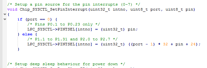

 There are some problems in both the 11U68 2.12 LPCOpen library and the 11E68.
There is type conflict error with pinMask function arguments in the gpio_11u6x c and h files.
I think it should be uint32_t pinMask.
-Missing closing brace for function in syscon_11U6x.c file:

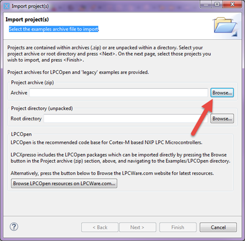

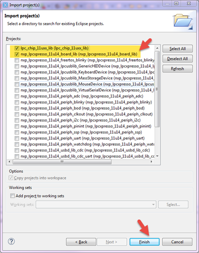

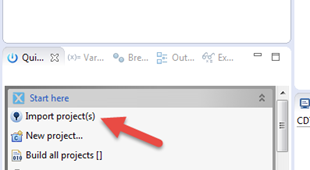

soledad
It is necessary to import the LPCOpen Chip Library for the device used and optionally the LPCOpen Board Library Project. For do that it is necessary to follow these steps:
1. Click on Import project(s).
2. Select the examples archive file to import. In this case, the projects imported are contained within archives .zip.
3. For this example the LPC11U14 LPCXpresso board is selected. Click Open. Then click Next
4. Select only the LPCOpen Chip Library and LPCOpen Board Library Project. Click Finish.
The same steps are required for any LPC device and board you are used.
Sol

lajostoth
Thanks for help!
I followed these steps based on tutorial:
https://community.nxp.com/docs/DOC-333169
but I used 11e68 library.
I get the same result with initial source code.
