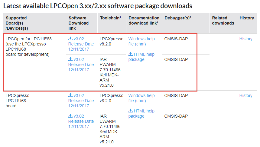

Hi Christopher Nocker,
To provide the fastest possible support, I've highly recommend you to refer to the periph_uart_rb demo for details.
Ping
