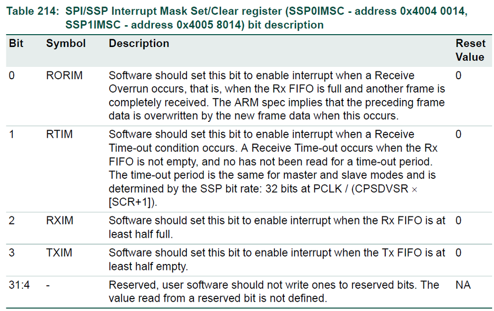

Slave on the other hand is having all sort of problems there. My interrupts on "RX not empty" and "TX not empty" kicked in immediately after initialization of the SPI. And after that SPI get stuck with BSY flag constantly on. No further interrupt happen on slave, even though logic analyzer is showing data.

2) Will Slave receives that as "RX not empty" interrupt?
-- Actually, I don't find the "RX not empty" interrupt in the Interrupt Mask Set/Clear Register, whether you can clarify it.

Enabling interrupts just ends with getting overruns. I cant seem to clear the overrun with writing to ICR. My interrupt just gets called again in next cycle. So, basically I get stuck in interrupt deadlock. Thats my original issue explained in the original question.
Why is writing to ICR not clearing overrun interrupt ? Do I need to read from DR even though I got timed out to clear the interrupt ?
I was referring to RXIM interrupt.
