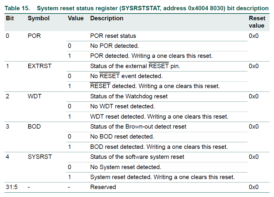

On LPC11C24 (Cortex M0) i try to find a cause of my MCU reseting.  User manual says that reset value of the SYSRSTSTAT  register is 0 after RESET. But this is not what I observe. Using MCUXpresso when i pause debugging and press 'Restart' button I see POR in SYSRSTSTAT bit still set. This should not be according to table below. Based on my experiments EXTRST and SYSRST reset sources do not clear POR flag. Does this mean that not all RESET sources are equal? Why are not all reset sources set to zero when executing system reset SYSRST via debugger?

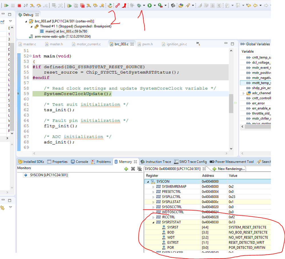

step 1
power up the OM13093 eval board
step 2
start a debug session by pressing button #1. Now 3 bits are set in SYSRSTSTAT register - POR, EXTRST, SYSRST
step 3
run program
step 4
pause program
step 5
reset progam by pressing a "Restart" button #2. All 3 bits are still set in SYSRSTSTAT register even though there was no POR.
step 6
run program
step 7
press reset button on the eval board. This will cause the IDE to show error msg. Press OK
step 8
Only when I clear SYSRSTSTAT register by calling  Chip_SYSCTL_ClearSystemRSTStatus(0x1F); function will I see real source of my reset. Why is that ?

I had replicated the issue on my site, and I suspect this issue is about the debugging operation.
You can use the following code to get the value of the SYSRSTSTAT register, then using the UART to send it to terminal without entering the debugger mode.
sysResetStatus = Chip_SYSCTL_GetSystemRSTStatus();‍

Explain: Because the board have external RESET pin reset circuit, when power on, the chip experienced two kind reset: POR and  external RESET pin reset, so POR and EXTRST set. And the SYSRSTSTAT can show the source of the latest reset event. But if don't clear the other bit, the other bit still will be set. Only write a one to clear it, or POR.
Hope this is clear.
