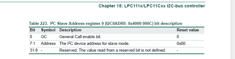

f_fiorini
Hi kerryzhou‌,
I think I found the problem: apparently the code works with 7-bits addresses and not already formed 8-bit ones... because now the communication works :smileyhappy:
5,910 Views
kerryzhou
Hi Federico,
   Good information!
   Yes, the LPC I2C address is 7 bits, so normally in the code, you need to lef shift one bit:
  But, if you check the official lpcopen code, it will be very clear.
Kerry
