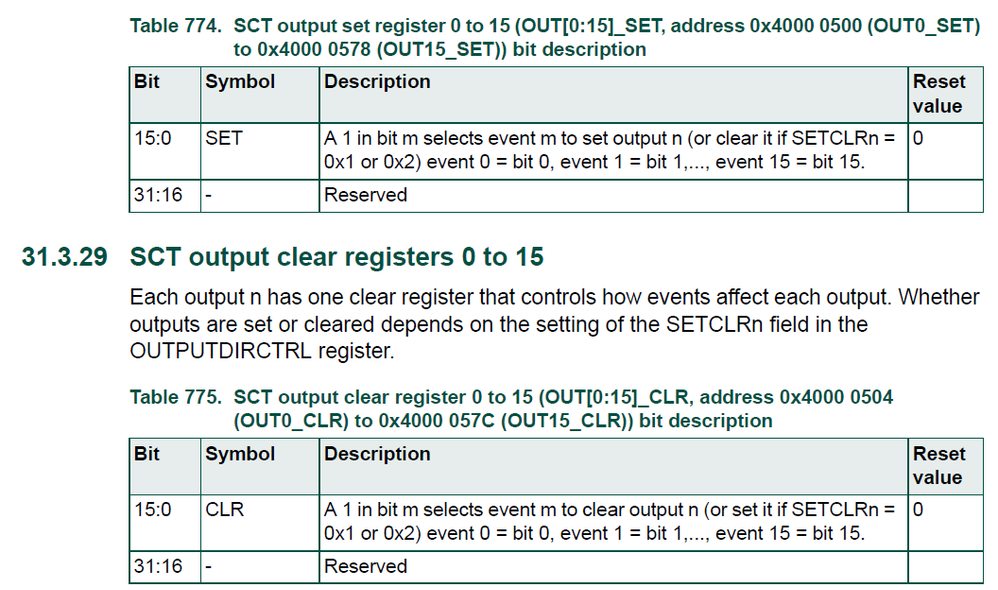

jeremyzhou
Hi ravi thakur,
Maybe you can select the COUNT_n as the trigger, for instance CTOUT_0.
The SCT can detect external signal of I/O as event likes Fig1 indicates, then the event can arise the SCT_CTOUT_n output high or low level (Fig 2).
                                                                           Fig 1
                                                                          Fig 2
