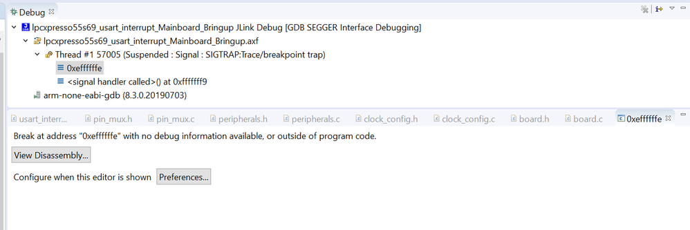

After changing the I/O in an example project running on a board that uses the LPC55S66JBD100 and starting the debug session, the following SIGTRAP error occurs. What could cause this error? Issue with the code or the debugger configuration?

Looks like it is possibly stack corruption. When you say "Changing the I/O" what do you actually mean - what, exactly, did you change?

First we need to identify the problem is on project or IDE system.
Please create a NEW workspace and import a NEW demo code ( for example led blink demo), see if the problem exists? if no issue, import your working project into this new workspace, how is the connecting?
