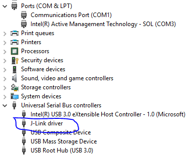

I am having a very similar problem. I have 2 LPC-Link 2 Rev B boards.
Windows 10
After installing LPCScrypt_installer_1.8.2_723.exe I plug in the boards and both show up in device manager.
Then I run program_JLINK.cmd
LPCScrypt - J-Link firmware programming script v1.8.2 April 2017.
Connect an LPC-Link2 or LPCXpresso V2/V3 Board via USB then press Space.
Press any key to continue . . .
Booting LPCScrypt target with "LPCScrypt_158.bin.hdr"
LPCScrypt target boot failed:
More than one DFU capable USB device found, you might try `--list' and then disconnect all but one device
So I alternate boards. Both show :
Cannot open device
Oddly, I was able to flash one of the boards after reinstalling drivers and rebooting. But I do not seem to be able to achieve the same results again.
The board that was flashed does not work however; it is not enumerating a COM port but shows a USB device. I have used a jumper on JP1 here.

stephenfrench
As a follow up, the device registered as a VCom port after the initial successful flash, but after a power cycle and jumping JP1 it only ever registers as a J-Link driver.
13,720 Views
stephenfrench
I have the system working now. It does not present as a VCOM port but that is fine. The issue was the devices being blocked sporadically by 'security' software on the development PC (without it mentioning it had blocked the devices!)
