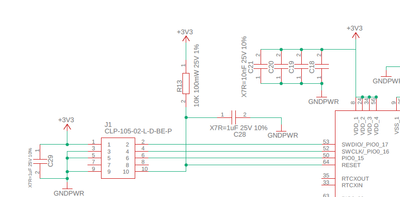

I am preparing the schematic for the LPC54102J512BD64QL.
I have a perplexity regarding the JTAG connections.
Is it ok?
The TDI is not in use according to the evaluation board schematic.
Just suggest ..
Thank You
Pietro

I recommend you review the datasheet in section 13.3 Connecting power, clocks, and debug functions. The TDI is not populate because the interface is SWD, some uC doesn't have the interface of JTAG.
For more information and details consult this page. https://community.nxp.com/t5/LPCXpresso-IDE-FAQs/Design-Considerations-for-Debug/m-p/469565
