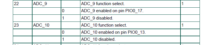

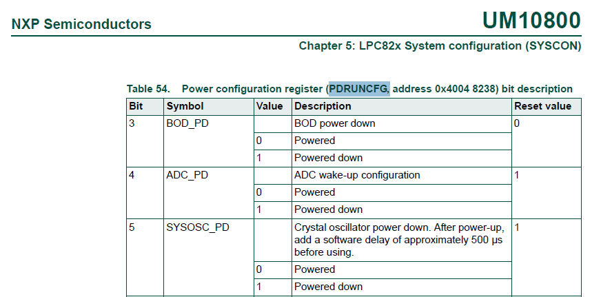

I'm trying to read an analog signal on ADC 9 & 10. The issue I'm facing here is, despite setting the start bit to 1 the ADC is not launching the conversion sequence, i.e. the interrupt service routine isn't firing and also there is not update in the flag register. Kindly help. I have mentioned the initialization function below.

1)clear bit4 to power the ADC, but you do nothing with the code. Setting bit4 to power down rather than power up.
LPC_SYSCON->PDRUNCFG |= (0<<4); //Power the ADC
modify it to:
LPC_SYSCON->PDRUNCFG &= ~(0<<4); //Power the ADC
2)clear the bit in PINENABLE0 to enable the ADC function for the pin, but you set the bit with the code:
LPC_SWM->PINENABLE0 |= (0<<23); //Enable ADC_10 on PIO0_13
LPC_SWM->PINENABLE0 |= (0<<22); //Enable ADC_9 on PIO0_17
You should use
LPC_SWM->PINENABLE0 &=~ (0<<23); //Enable ADC_10 on PIO0_13
LPC_SWM->PINENABLE0 &= ~(0<<22); //Enable ADC_9 on PIO0_17

flourishaprince
Thanks a lot. This solved the issue.
