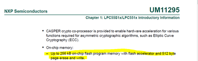

What is the FLASH page size for the LPC55x14 and x16?

By the text you supply it indicates 17 pages in reserve, so it should not be one contigous space. but 12KB/17 pages is 722.8 bytes/page which is also odd.

JK_265
I found this:
