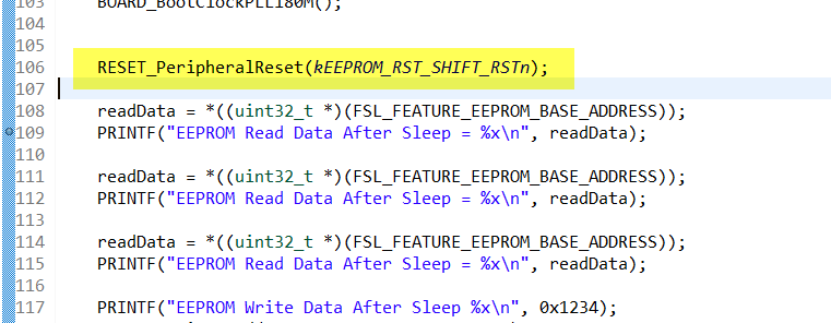

Working with LPC54605J512BD100 encountered a strange problem with on-chip EEPROM. After MCU exiting deep sleep mode and read from EEPROM, data get corrupted.
I used the SDK_2.6.0_LPC54605J512eeprom example and MCUXpresso IDE to demonstrate the problem. The code is straight forward, write data to EEPROM, switch the clock to fro, deep sleep, woke-up by RTC, switch to pll out, and first read returns corrupted data. The next 2 reads are ok, but if perform EEPROM write and try to read back the result will be 0. After that, write-read operations work fine. Here are Log messages.
EEPROM example begins...
EEPROM Write c0de
EEPROM Read Data Before Sleep = c0de
Enter Deep Sleep!
Sleep Time = 100 ms
EEPROM Read Data After Sleep = 99939b08
EEPROM Read Data After Sleep = c0de
EEPROM Write Data After Sleep 1234
EEPROM Read Data After Sleep = 0
EEPROM Write Data After Sleep 5678
EEPROM Read Data After Sleep = 5678
I'm using libpower_softabi.a. Add project to attachments.

Helllo Alex Tepliy,
After waked up from deep sleep mode, try to reset the EEPROM:
    RESET_PeripheralReset(kEEPROM_RST_SHIFT_RSTn);
TIC
1,931件の閲覧回数
emblink182
Dear Alice_Yang, thanks for your answer! Peripheral reset fixed this problem.
I have a few extra questions if you mind answer them.
1) Do I need to call eeprom_init after peripheral reset call?
2) In your opinion, what was the cause of the problem?
3) I inspect the source code of libpower.a and found a define PDRUNCFG0_PD_VDDCORE_EE witch marked as a reserved field in the datasheet. When I add this define to DEEP_SLEEP_ENABLED_PERIPH together with SYSCON_PDRUNCFG_PDEN_VD6_MASK  eeprom worked fine. Does this flag relate to eeprom?
