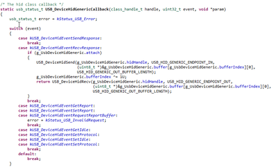

The buffer sending the information is called in the USB callback when  a kUSB_DeviceHidEventRecvResponse event is called:

Yes I've noticed, but it's not working.
The two functions always return a busy status. It seems like a common issue, as seen

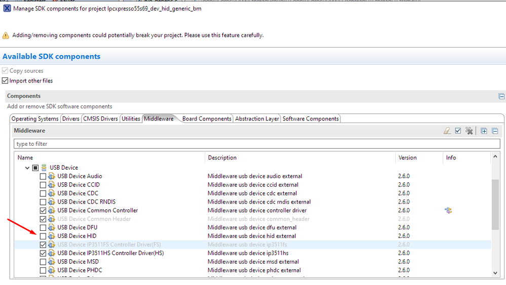

In addition, I'd like to know why the usb_device_hid_generic demo has no USB HID drivers by default. See the screenshot below for reference.
If I add the drivers manually, the generated code conflicts with the rest of the code.

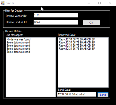

After downloading the example to my board and connecting it, the device should be enumerated in your computer, if you look with a sniffer you could see that this is detected as HID Class:
The readme mention the tool that it needs to be used and the changes need it but if you don't want to compile again here someone already does it.
The result should be like the next one:
