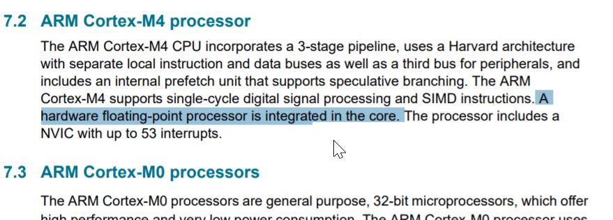

Can anyone confirm if the LCP4367 has a FPU? The web information appears to be contradictory in this regard.
2,386 Views
soledad
Yes, for this device a hardware floating-point processor is integrated in the core. You can confirm this information in the datasheet https://www.nxp.com/docs/en/data-sheet/LPC436X.pdf
