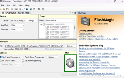

Hello, I am trying to flash the controller via UART port using FLASH MAGIC on LPC54628 evk. Below fig. shows the configuration for flash magic:
During first flashing attempt, I accidently erased the whole chip by checking the erase entire device option in flash magic. After this, the device is not getting either in Flash magic or in MCUxpresso IDE. Looks like erasing the entire chip has erased the bootloader as well.

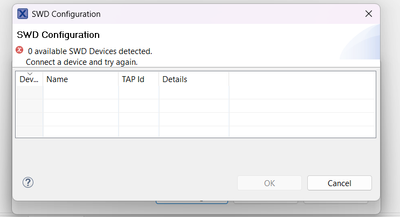

I am getting following error in MCUxpresso IDE:
Error: 0 available SWD Devices detected.
In what way I can recover the MCU from this stage ?

I am getting following error in MCUXpresso-IDE  :

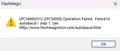

We initially programmed the demo GPIO, and the execution was successful. We also configured the device in ISP mode and attempted to erase the Flash using Flash Magic. However, we encountered the following error:
Despite trying all the supported baud rates in Flash Magic, the error persists.
