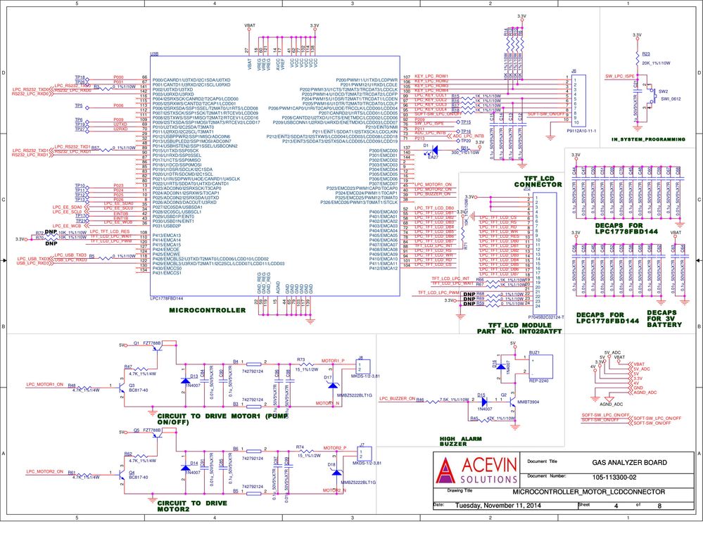

sakib
hello, Sabina,
Thank you for your help. up till now, the LCD is displaying the desired output. I am using the Displaytech INT028ATFT LCD module.
now I hope the pull-up/pull-down issue has been sorted but the problems happening are
1.when I am connecting the LCD module to the LPC controller after approx five to ten minutes the LPC controller stops operating and sometimes just at the moment of connecting the LCD.
2. with the LCD still connected it displays the same picture, but I am unable to restart(reset) the LPC controller or reprogram it.
3. when I disconnect the module(manually disconnecting the connector) the controller restarts and works normally.
 I am posting an image of the schematic for your reference.
sakib khan
3,693 Views
Sabina_Bruce
Hello Sakib,
This sounds like it could be a power distribution issue. I would recommend to mesure the supply currents and voltage as stated in the data sheet for both the LPC1778 and your LCD module.
Here make sure that you are not getting a sudden unexpected drop in the votlage or current when you connect the LCD. From your schematic I see that all power lines ar connected to the same 3.3V. If you do see an anomily, please try to  separe the power sources and measure these points again.
Let me know your results,
Sabina
