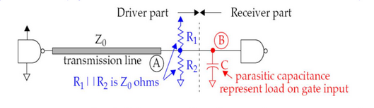

Is it safe to connect two different LPC4370 MCU Unit of GPIO pins directly to each other? such that LPC4370 MCU1 transmitter of GPIO0[0] connected directly to the LPC4370 MCU2 receiver of GPIO0[0]

I am working on an LPC4370 project that requires me to route the output of one GPIO pin in transmitter MCU1 into the input of another GPIO pin in Receiver MCU2 .so I have thinking of connecting directly to each other.
I will be configure a one pin as output and another as input. Is it it would  create any trouble.
Thinking about it in retrospect, putting a current-limiting resistor between the two pins would have prevented any worries, or it would require any hardware design to do at this point.
Can we connect directly?
Is it possibility of a programming error causing both to be (possibly conflicting) outputs

Hi Sujay,
I'm working on the LPC4370 too in these days, but I'm far to be an expert, so take everything I say as a piece of advice and not a go to solution.
However, since this is intended to be a transmission line I'd expect an adapted termination to avoid reflections, and while designing it I'd be careful about the tolerance of the LPC4370 in terms of input/output currents.
Here's a simple schematic of (what I think might be) a possible solution.Selection_027.png
A well known book for reference is the following: High Speed Digital Design: A Handbook of Black Magic: Martin Graham: 9780133957242: Amazon.com: Book...
Good luck with your project.

Hi ,
Thanks for the Reply, actually it is possible to add any High-Speed Differential Line Drivers and Receivers ICS between the 2 GPIO pins such that propagation delay is in few 5.0 nano seconds and the current limiting any where between +/- 30 mA
