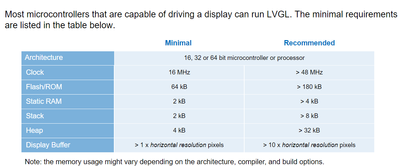

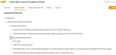

Is LVGL the best choice for LPC1788? In web site:https://www.nxp.com/design/software/embedded-software/lvgl-open-source-graphics-library:LITTLEVGL-OP...
       LPC1788 is not contained in the supported devices。Can LPC1788 run LVGL easily?  Is there a   code template related LVGL for LPC1788.
2,422 Views
You can check with the below picture:
There is only code template and demos for new products of NXP as the link you mentioned.
