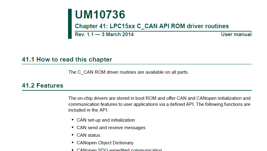

ianbenton
Senior Contributor I
Thank you - it helps a little. If you were writing to the LPC15 CAN registers, it would be easy to see what was happening, as I would just look up the function of each particular register in the manual, and I would know what it did; but because you are calling C functions, and there is no manual (as far as I am aware) to say what parameters are passed and returned, in most cases, I am none-the-wiser.
4,942 Views
carstengroen
Senior Contributor II
If you look in the Users Manual, there is 15 pages of documentation of the C_CAN ROM drivers that I use ?
Its really not that complicated
4,942 Views
ianbenton
I have read Chapter 41, and found the terminology arcane; but it is beginning to make more sense as I read it in conjunction with your software and Chapter 27. I was particularly amused by 41.4.2 - I'm glad I wasn't the only one who was confused!
I know it's not complicated - after all it is nothing but a glorified UART, and anyone who has ever used a MC6850 doesn't need software drivers provided for him before he can use it! It's cleverer than RS232/485 in that it can do all the arbitration  and error checking stuff, but simpler in that the message format is fixed.
A couple more things that are still puzzling me:
Do the API ROM drivers run the interface in "basic" mode or in whatever the other mode is called?
Why does it need RAM to be allocated to it? It has lots of RAM built in, doesn't it?
and just for interest's sake - does it figure out the baud rate for itself, or do all the nodes on the network have to be set to the same baud rate - if so, is there a common baud rate or does everyone use something differrent?
