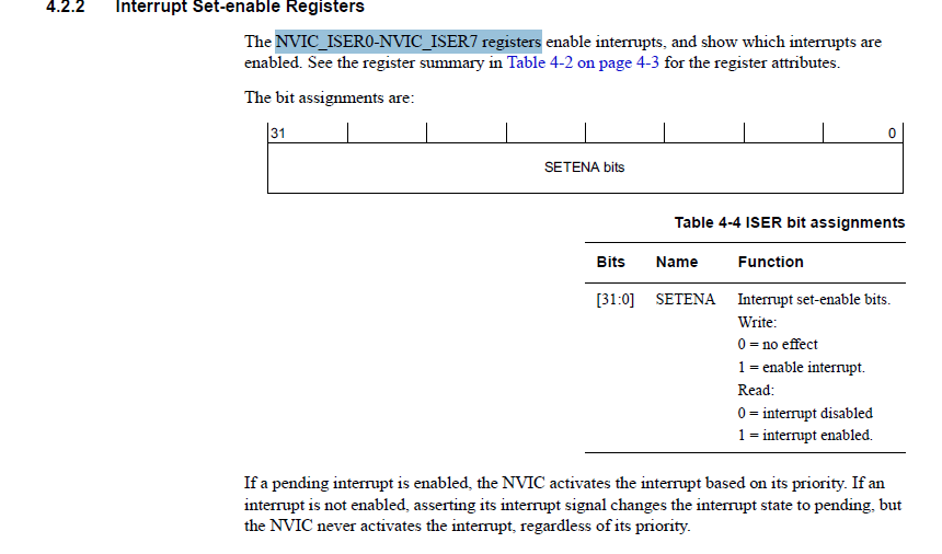

Thank you for your replay XiangJun Rong,
I have checked this information to confirm my belief is that both interrupts are enabled.
I do see both interrupts handled by the software. My confusion is that they do not seem to be "chained" when I step through the process with the debugger. To be clear this is the situation:
Timer32B0 and TImer16B0 both monitor the same signal - it is shared between both timer CAP0 input pins.
Both timers are configured to capture a low to high edge with debounce of their input pin and generate an interrupt which is enabled in the NVIC.
Each ISR copies the captured time for use in the main program execution.
When I run the application I calculate the time between captures and output it in a short 115200 baud message, which is shorter than the interrupt time.
What I see is that one interrupt sometimes does not get called - and the time for that measurement is doubled.
I then make a breakpoint in one interrupt and I look at the interrupts, pending, enabled and in process by looking at the NVIC.
What I see is one in process and one pending. I step through the ISR for this interrupt but first I switch off the interrupting signal so the state of the inputs is fixed. As the ISR completes I see the first interrupt cleared and no longer active or pending. The second interrupt is still pending, and still enabled but the controller returns execution to main(). I step over many hundred lines of code before the second interrupt processing begins. I do not understand why chaining did not occur as described in the ARM exception handling manual.
I wonder if this is due to debugging, or something I cannot see clearly in the NVIC.
So, to recap - both interrupts fire but there is a "long" delay between the first and second one when I expected them to chain with no return to main.
I can make a screen grab of the NVIC registers showing the two active sources that have been detected by the NVIC to show this, if I can work out how to attach it :-)
I appreciate your interest in my problem

xiangjun_rong
Hi, Ian,
Each interrupt vector has ONE bit in Interrupt Set-enable Registers which is from NVIC_ISER0-NVIC_ISER7 registers depending on the processor itself. You have to set the corresponding bit in the NVIC->ISERx register to enable the interrupt.
Regarding your issue that the second  CTimer interrupt can not fire an interrupt,  I suppose you do not set the corresponding bit in NVIC->ISERx, pls check it.
Hope it can help you
XiangJun Rong
