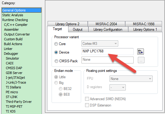

jeremyzhou
Hi mino simpson,
for the opportunity to serve you.
The project is specific to LPC1768, and please use below library instead of the previous one.

minosimpson
Hi jeremyzhou‌,
Thank you for your answer, but my problem is not resolved.
I used the project that you sent. when I remove startup file, debugger goes to main and then to UARTSend but nothing was sent that I think this is because of removing startup.
when I add it, debugger doesn't go to main.
Also I changed device name in general option to lpc1788.

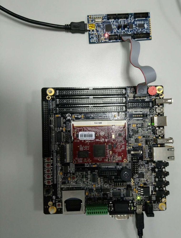

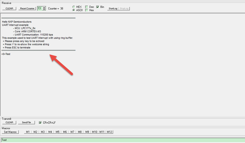

jeremyzhou
Hi mino simpson,
Thanks for your reply.
I'd like to indicate the testing process I did.
1. Assure the configured Device is LPC1788
2. Change the value of UART_TEST_NUM to select the J25 as the Serial port.
//#define UART_TEST_NUM       1
#define UART_TEST_NUM       0‍‍‍‍
3. Debug.
Obviously, the demo works well, I don't encounter the phenomenon you mentioned.
