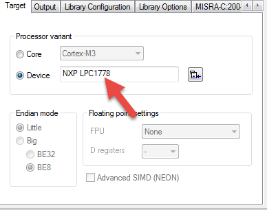

minosimpson
Hi jeremyzhou‌,
Thank you for your answer, but my problem is not resolved.
I used the project that you sent. when I remove startup file, debugger goes to main and then to UARTSend but nothing was sent that I think this is because of removing startup.
when I add it, debugger doesn't go to main.
Also I changed device name in general option to lpc1788.

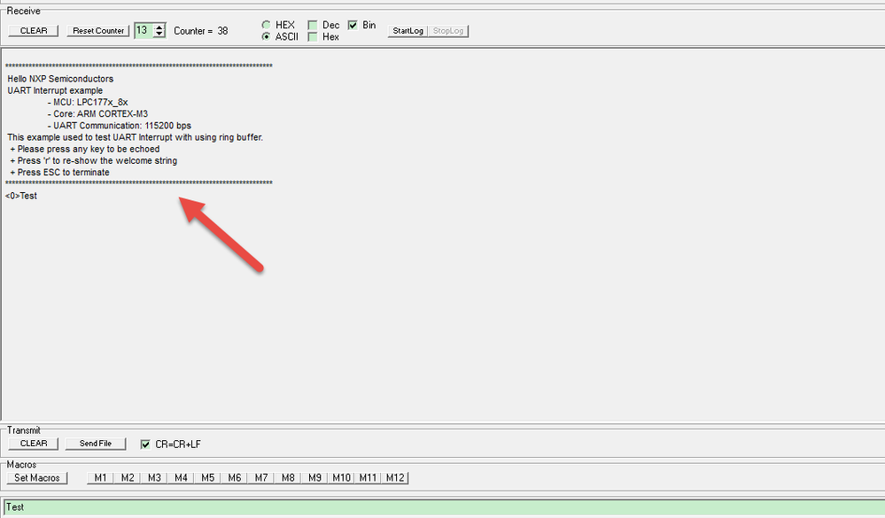

jeremyzhou
Hi mino simpson,
Thanks for your reply.
I'd like to indicate the testing process I did.
1. Assure the configured Device is LPC1788
2. Change the value of UART_TEST_NUM to select the J25 as the Serial port.
//#define UART_TEST_NUM       1
#define UART_TEST_NUM       0‍‍
3. Debug.
Obviously, the demo works well, I don't encounter the phenomenon you mentioned.
