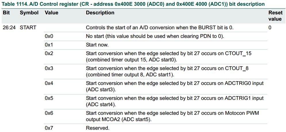

1. Can I change the sensitivity of the triggering of an interrupt?
Now, the ADC can support to select the trigger source (See Fig 1).
                                                                       Fig 1
2. Can I somehow filter values that are too low and trigger interrupt under a given threshold?
The ADC doesn't support the feature.
