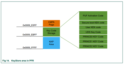

The Platform Security Architecture is part of the ARM architecture, so we don’t have many documents pertaining it. The persistent keys are storage in isolated or shielded locations so these would not be lost on power off.
For the LPC55SXX in particular, you may see where the keys are stored in the protected flash region in the worksheet attached to its user manual (UM11126).

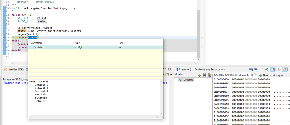

After running psa_generate_key () on PSA TEST: 216, dumped memory address 0x9E600.
Unfortunately, I have confirmed that the data is zero clear.
Is the ability to store keys in storage supported?
  • UM11126 P.142
  • before
  • after
