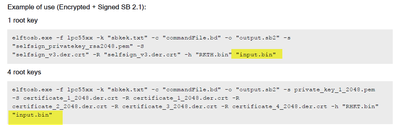

I encountered the following issue while testing Secure Boot on the LPC55S69 (revision 1b) following the AN12283 guide:
Everything is working fine until the SB2 file load step (§ 5.6.3).  After I executed the `receive-sb-file` command with my generated SB2.1 file and reset the chip, the firmware was not executed.  I am able to go back into ISP mode by activating the ISP pin and I can change the CMPA and CFPA configuration pages, erase the flash and flash new images, but none of the flashed images is actually executed after a reset.  Even if I erase the flash, the chip only boots into ISP mode if I also activate the ISP pin.
I am positive that the signature keys (ROTKH) are set up properly because flashing a signed image worked.  I also think that the SBKEK was setup correctly because the `receive-sb-file` command did not fail.
Do you know what could cause this behavior or how I can further debug it?
Robin
PS: This is the .bd file that I used to generate the SB2.1 image:

Hello Robin,
Please check in step 5.6.2 SB2 file creation, refer to the example for SB2.1:
Pay attention change the "input.bin" to the real name of your .bin file, and put the file in elftosb.exe path.
Alice

rnk
Hi Alice,
thanks for the reply! Here is the command I used to generate the SB2.1 file:
elftosb -f lpc55xx -k "$sbkek" -c "config.bd" -o "$output" -s "$key" -S"$cert" -R "$cert" -h"$rkth" "$binary"
$binary is the name of the binary file. The size of the binary file is ~ 17kB and the size of the SB2.1 file is ~ 20 kB, so it seems like the SB2.1 file contains the binary file.
What irritates me most is that even if I disable Secure Boot in the CMPA and flash an unsigned image, it is not executed any more.  Do you have any ideas why?
Best,
Robin
