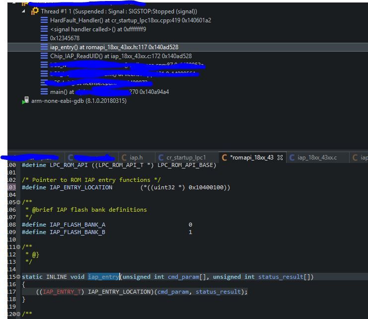

I am using the LPCOpen library at the moment with MCU LPCExpresso IDE for  the LPC1830 chip.
For a project I need to read the UID of the CPU. I tried it with the following functions:
But it crashes and I don't know why. Maybe someone can help me?
I increased the cpuUID size to 5, but 4 is enough.
Program counter has weird number: 0x12345678
uint32_t cpuUID[5] = {0};
 Chip_IAP_ReadUID(&cpuUID[0]);
//The function call crashed on this function:
/* Read the unique ID */
uint32_t Chip_IAP_ReadUID(uint32_t uid[])
 uint32_t command[5], result[5], i;
 command[0] = IAP_READ_UID_CMD;
//CRASH
 iap_entry(command, result); //IAP ENTRY CRASH
 for(i = 0; i < 4; i++) {
 uid[i] = result[i + 1];
 return result[0];
Note in this picuture: uint32 needs to be uint32_t (line 103)

IAP is intended to deal with an internal flash. There would be commands like ReadUID which do not work directly on the flash, however it is a restriction in the flashless parts of LPC1800 and LPC4300.
See error sheet, chapter 3.4
https://www.nxp.com/docs/en/errata/ES_LPC18X0.pdf
Bernhard.

Thanks for you answer Bernhard. After searching in the datasheet I found the same information.
To fix this issue I used the following code to just read the UID of the CPU:
Chip_OTP_Init(); //located in  "otp_18xx_43xx.h"
unsigned char buf[16];
uint32_t * pntrID = (uint32_t *) 0x40045000;
memcpy(buf,pntrID,16); //this will copy from memory location 0x40045000 16 bytes into an buffer. Containing the UID.
//DumpHex(buf,16,"UUID"); //own function
