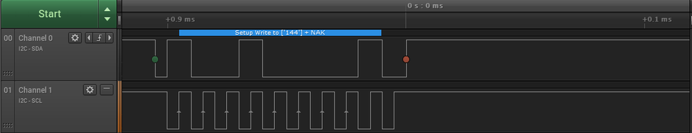

In this example, you can select which I2C interface you want to use, checking the code, the part when the I2C1 pins are configured is the same as you are doing, only disable the glitch filter too.  I put 2.2Kohm pullups on each I2C1_SCL and I2C1_SDA signal line and with the help of a logic analyzer to check the I2C wave, I get this:
I get that signal transition, so if you don't get anything, check the example, maybe something is missing, or provide your source code, to see whats happening.
