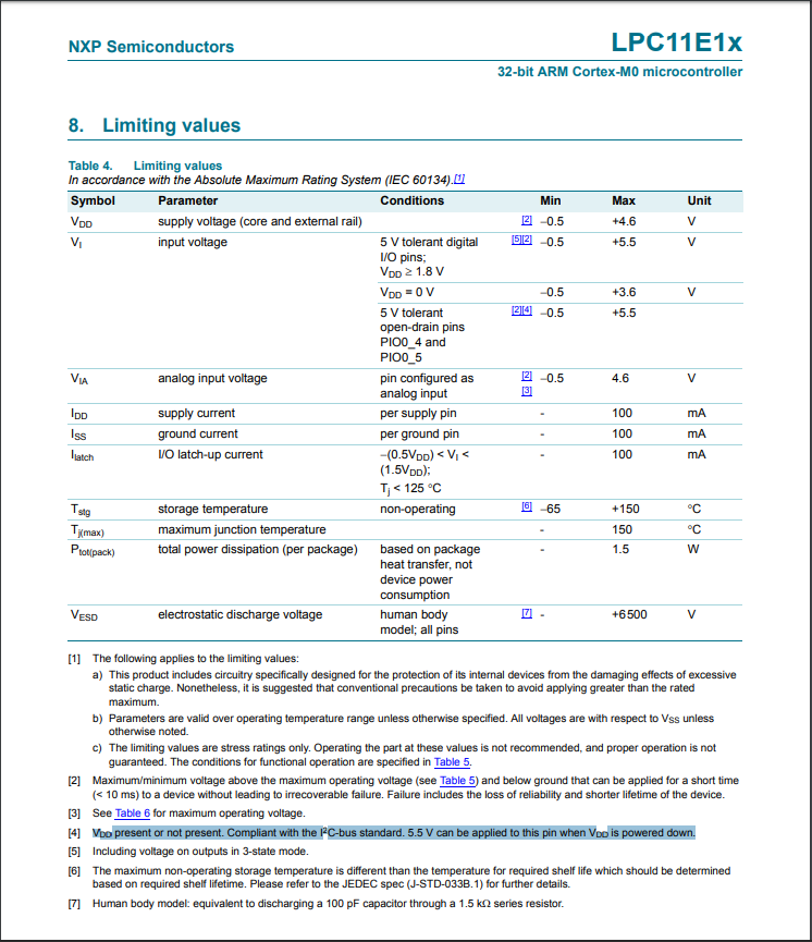

edos
Hi thank you for the fast answer.
I referred to the datasheet of the LPC11E14  https://www.nxp.com/docs/en/data-sheet/LPC11E1X.pdf
There is written:
[4] VDD present or not present. Compliant with the I2C-bus standard. 5.5 V can be applied to this pin when VDD is powered down.
So we designed like our system like that. Our System already has serial resistor of 46.4Ohm
What do you suggest in that case ? Increase the serial resistor or ?
Best Regars
2019-01-04 09_30_54-LPC11E1x 32-bit ARM Cortex-M0 microcontroller; up to 32 kB flash; up to 10 kB SR.png
3,609 Views
xiangjun_rong
Hi, Edos,
Regarding the Note 4, I suppose it means that the chip is not damaged when the 5.5V I2C signal is applied to the pins while the chip is power down. It does not means that the i2C node can work.
I suggest you increase the serial resistor to suppress the effect from the I2C module which is power down.  But increasing resistor may have impact on the I2C module when it is powered up. so you have to make balance to choose the resistor value.
Hope it can help you
XiangJun Rong

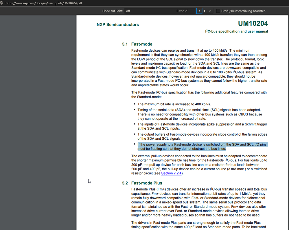

edos
Hi XiangJun Rong
Thank you for answer. I checked the I2C specifications which the Datasheet is referring to. There it says that the I2C Bus shouldn't be influenced of the MCU if this one is powered off.
I have to check if we are able to increase the resistor value.
Otherwise we have to implement a bus switch to cut the I2C signals from the MCU if its not active so that the MCU is not influencing the signal
Best Regards Edos
