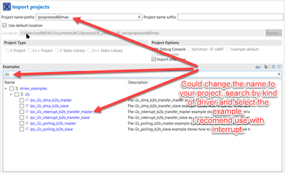

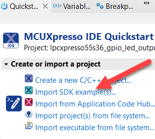

Pavel_Hernandez
Hello, my name is Pavel, and I will be supporting your case, I recommend review the documentation of your sensor maybe the sensor will need a low performance of the I2C. In other words, maybe your I2C settings are not supported by your device.
Use these steps to find the examples on the MCUXpresso.
Please let me know if there's anything else that I can do for you.
