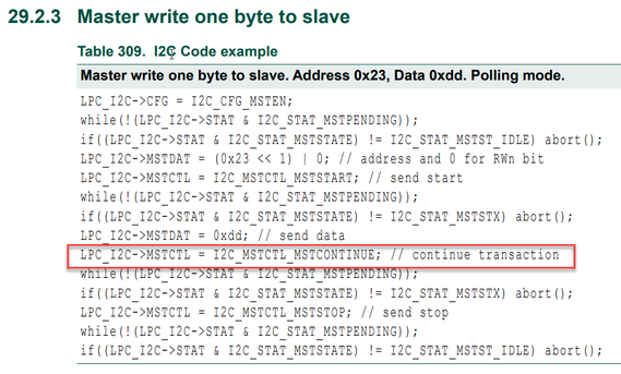

I wrote a program using Chapter 29.2 “Code Example I2C” as a reference, but it isn't working properly.
Currently, I cannot visualize how the LPC810 operates when controlling as a master using hardware I2C.
I believe the code example lists three constants to set in LPC_I2C->MSTCTL: I2C_MSTCTL_MSTSTART, I2C_MSTCTL_MSTCONTINUE, and I2C_MSTCTL_MSTSTOP.
I2C_MSTCTL_MSTSTART handles the start condition and restart condition, and also...
I2C_MSTCTL_MSTSTOP is for the stop condition,
but could you please explain how I2C_MSTCTL_MSTCONTINUE behaves in both master transmit mode and master receive mode?

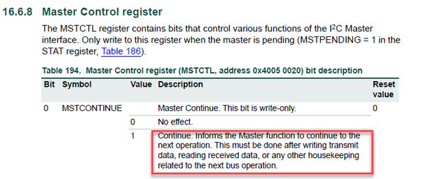

The macro I2C_MSTCTL_MSTCONTINUE is defined with a value of 1, as shown in Chapter 29.2.1 "Definitions". It is used in the MSTCTL register, which writes a 1 to the MSTCONTINUE bit. This bit performs the following function:
In simplified terms, this bit tells the LPC controller that it can proceed with the next operation in the I2C protocol. For example, if a transmission has already started and an ACK has been received, the next step might be to send a data byte to the slave. This is when the MSTCONTINUE bit is activated.
That is why, in the example "Master writes one byte to slave", the bit is set after receiving an ACK and before sending the data byte.
Habib

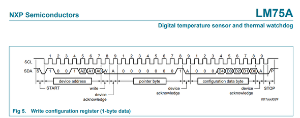

I highly recommend reviewing Section 7.10: "Protocols for Writing and Reading the Registers" in the LM75A datasheet. This section explains how the I2C communication frames should be structured to perform various actions with the sensor. For example, it includes the frame format required to write to the configuration register:
Additionally, there are other useful frame formats mentioned that can help you better understand the communication process. This section also highlights key aspects of I2C communication.
I also suggest checking out Section 7.3: "Slave Address", which explains how to configure the sensor's slave address.
