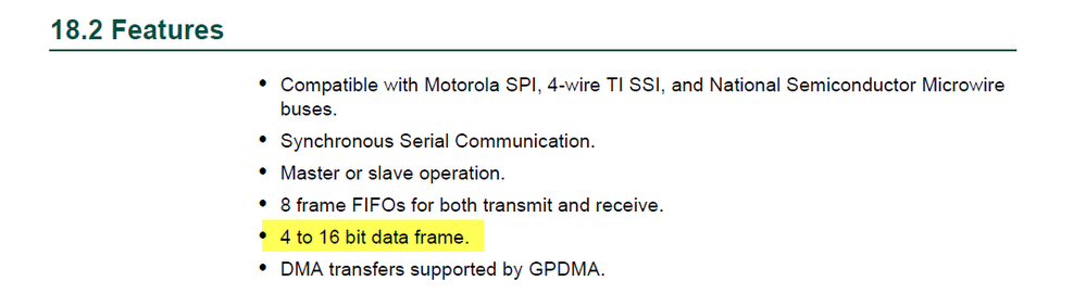

Considering using LPC MCUs for a project.
Need to interface to devices with 20-bit SPI frames, which is very common (for 20-bit ADCs, DACs, etc); for example:
http://www.ti.com/lit/ds/symlink/ads8904b.pdf
https://www.maximintegrated.com/en/ds/MAX5717-MAX5719.pdf
Note in particular the CS requirements in the either datasheet above (CS must be held low for 20-bit duration).
There many other 20-bit SPI parts with similar requirements.
I had a quick read of the LPC176x SSP description here: https://www.nxp.com/docs/en/user-guide/UM10360.pdf
I can't see how one does a transfer longer than 16 bits (which is supported for example on Kinetis SPI).
How does one do a 20-bit SPI transfer?

   LPC176X ssp can't support the 20bit SPI directly.
So, if you really want to use 20bit SPI, you need to use the GPIO to simulate it.
About the CS requirements, it's easy to realize it, just use the GPIO to control it.

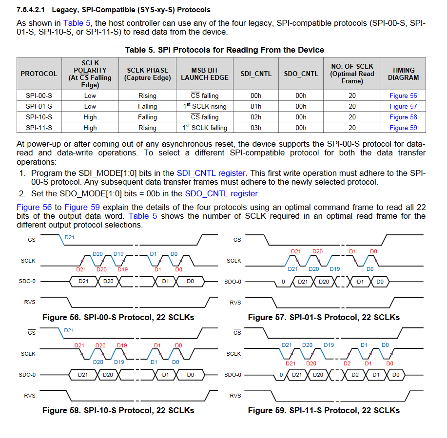

But I have roughly review your SPI slaves:
1. ADS8904B from IT
page 37
You can find it actually need 22 clocks.

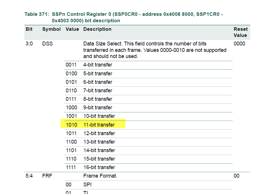

So, I think if you need to use SSP, you can use two 11 bits:
The CS can be controlled by the GPIO, don't use the SSP hardware CS function.
About the data, after you received two 11bits, you can combine two 11bits data together.

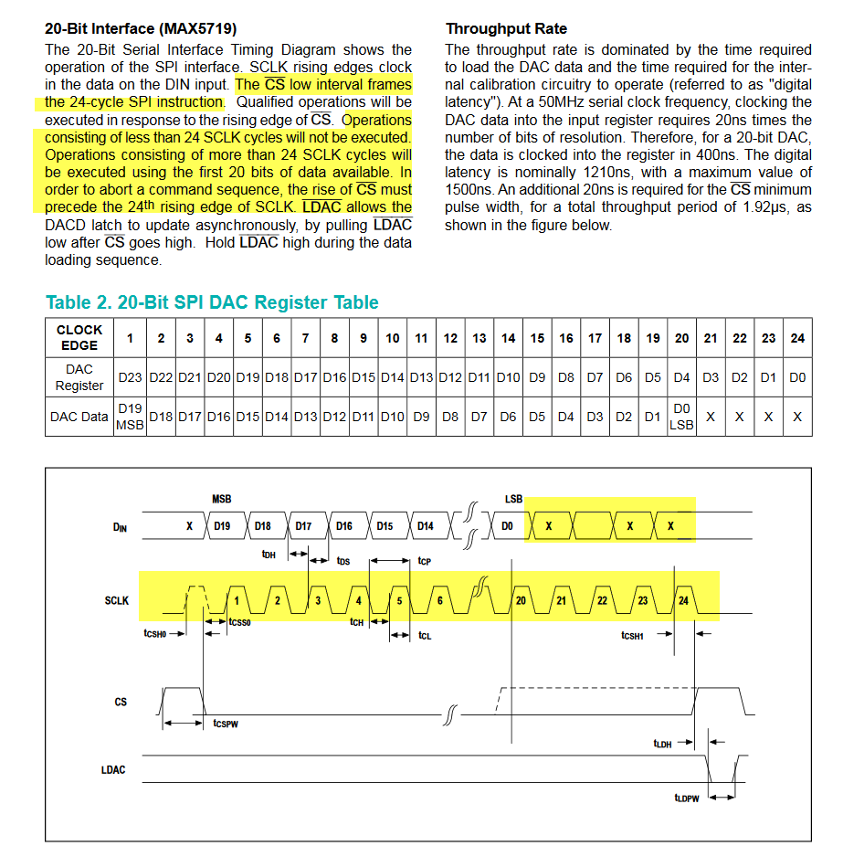

2. max5717 from maximintegrated
page 10.
You can find it is the 24 clocks, so you can use two 12 bits SSP or 3 8-bits SSP, then combine it together.
The CS pin still be controlled by the GPIO.
As I know, the SPI module in the LPC series, no chip can support 20 bits directly, so you need to divide it, or use the GPIO to simulate it.

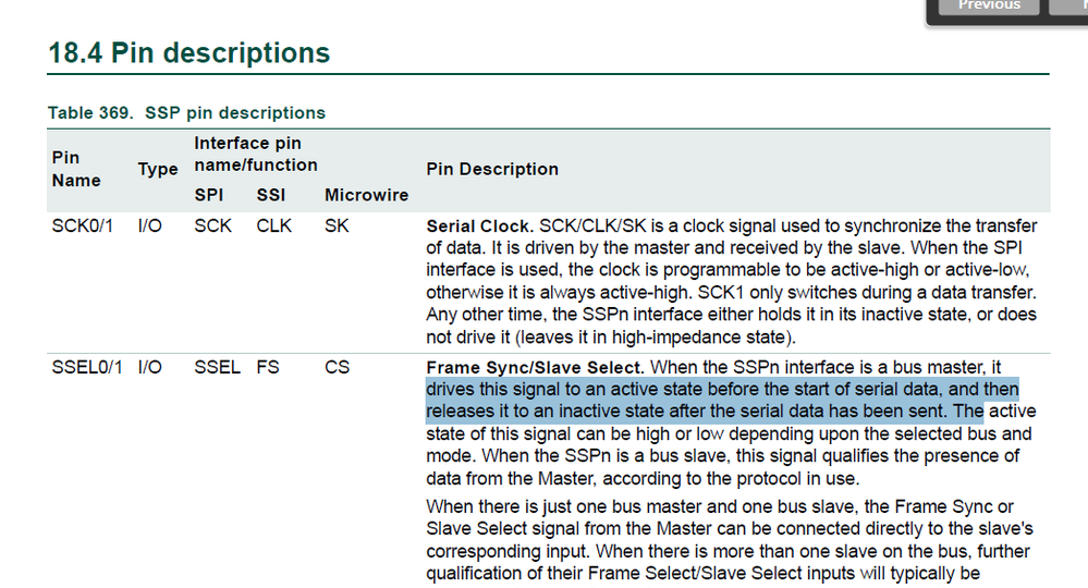

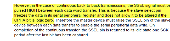

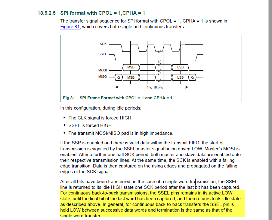

    Hardware control CS idle state is determined by the status, please check this information:
So, if you want to use the hardware control, maybe you need to choose CPHA=1, but you need to check your SPI slave, if you choose this method, your slave should also have the same CPHA. Otherwise CPHA=0, the SSEL will be pull to idle status after each data word transfer.
If you are using DMA, you can consider to use the CPHA=1.

  1. Yes, MCU can't support 20bit directly, but please check your slaver, actually it is 24 bits, so just as I told you, you can use 3*8bits to replace the 24bits. even it is the 20bits, you can use 2*10bits to replace it. But the data you need to prepare it in divide mode, then combine it together by yourself.
2. If the CS is low without software GPIO control, you need to use CPHA=1, this mode can keep the CS low without GPIO control. But CPHA=0, you still need to control it with the software. If you want to use the timers or DMA to control the CS, of course you can, but how to synchronize the SPI with the GPIO CS correctly is a problem, it will make problem more complicated. So, if you can't use CPHA=1, maybe you really need to consider to use cpu involvement.
