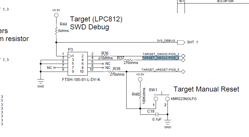

I have LPCXpresso812-MAX and need to program/debug LPC1102 using OBD. schematic shows the connector but I don't understand the exact way to isolate the LPC812 and direct to LPC1102.

     The LPCxpresso 812 MAX board didn't leave the connect to external chip with the OBD.
    So, if you want to use it, you need to modify the board, and connect the wire by yourself.

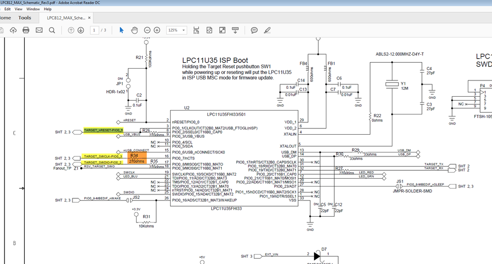

    As you know, the debugger interface SWD just need 5 wire: VDD, SWD_CLK, SWD_DATA, RESET and GND. Normally, if there two chip, the SWD_CLK wire must be isolated.
   From the LPCXpresso 824 MAX board schematic, you can try to modify these points:
1. remove the R34, and connect a wire in LPC11U35 pin 16, then connect it to your own chip's SWD_CLK.
2. Other swd pins: VDD, GND, SWD_DAT,RESET, you can use P3 interface
But all these pins you need to connect to your own board.
