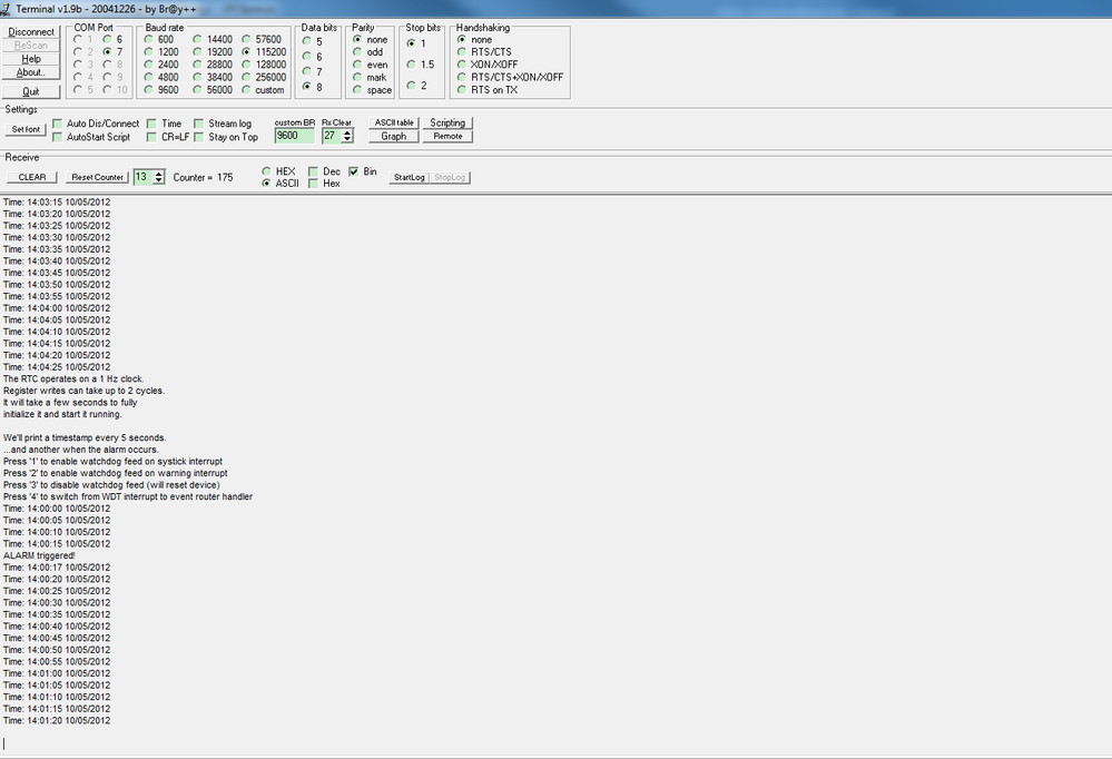

uaz
I've tried the example from lpcOpen. Results:
1. 32kHz crystal: working
2. 32kHz oscillator: Stuck in the ATIMER downcount loop during initialization. Seems like RTC peripheral is not getting 32khz clock
I also found that using 32kHz crystal + RTC is buggy when I use Watchdog at the same time.
You can try the following code:
[C] LPC4357 RTC + Wwatchdog - Pastebin.com
The program can run the first time, but it won't run the second time after I click 'Restart' button.

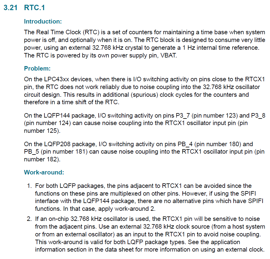

jeremyzhou
Thanks for your reply.
1. The 'bug' may cause the RTC to fail to run when using the external 32kHz oscillator, please follow the workaround to fix it.
2. Whether you mean that the demo ([C] LPC4357 RTC + Wwatchdog - Pastebin.com ) only can work once and it won't run anymore after reset.

uaz
1. I've tried the workaround:
  - Don't use the pin 180 and 181 of LQFP208: Same issue. If I use Watchdog along with RTC, the application will reset.
  - Use external oscillator: RTC won't work at all because the 32kHz signal is not detected.
2. If you try [C] LPC4357 RTC + Wwatchdog - Pastebin.com  your application will not run for second time ( after clicking restart, and then run button).
I sense that writing to RTC register (even after waiting 2 seconds during initialization) will cause the some glitch that slows down the processor, thus watchdog reset will trigger.
If I disable watchdog reset option, I will enter watchdog timeout interrupt when running with RTC enabled. If RTC is not enabled, I will not enter watchdog timeout. Seems like RTC is causing the main cpu to become unstable.

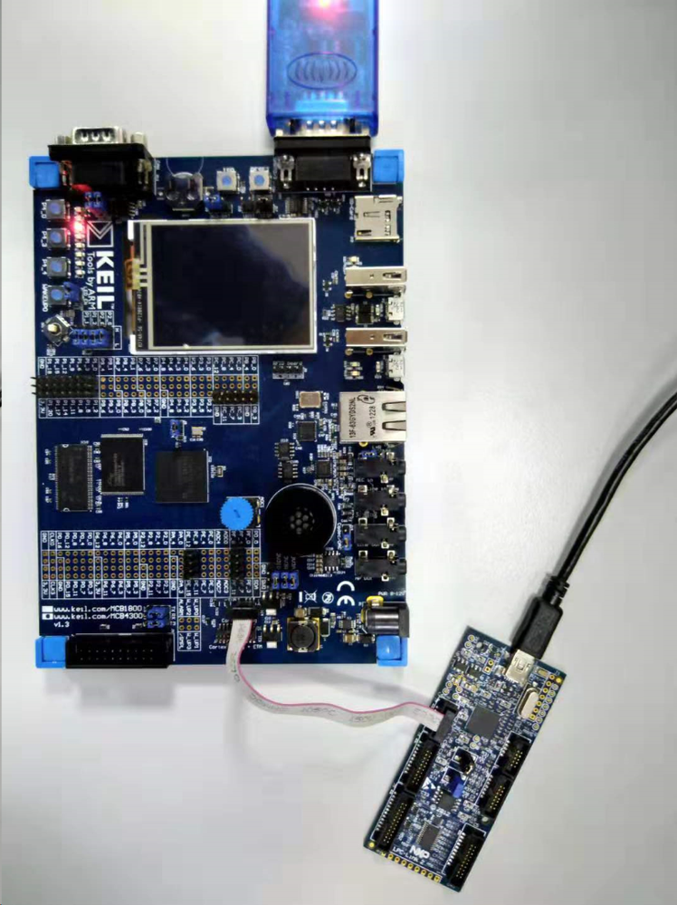

jeremyzhou
I've run the application on my board: MCB4357(please check the attachment), it can work well after clicking the restart button, it doesn't encounter the issue you mentioned.
Fig 1 MCB4357 board
Fig 2 Testing
TIC

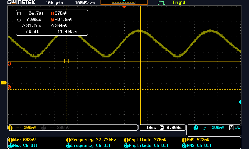

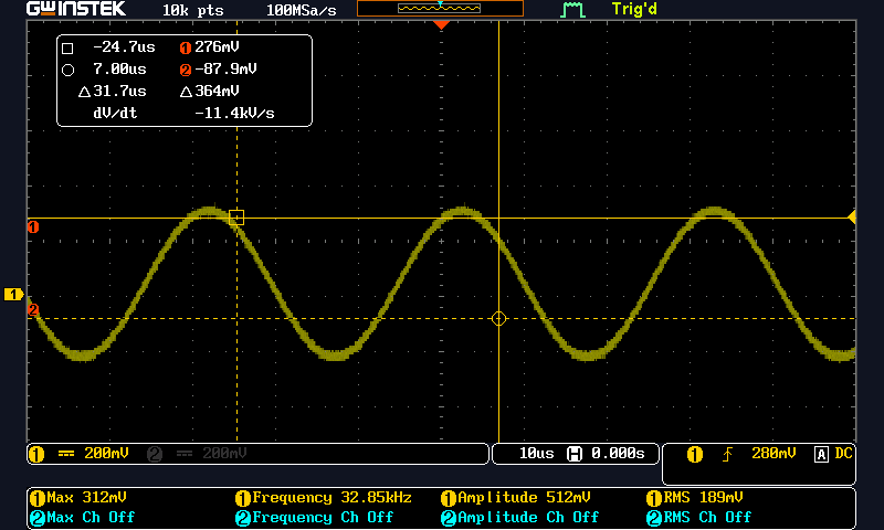

uaz
Strange. I have confirmed that my mcu will stall/glitch whenever I write to the RTC registers. It probably caused by the board design since I'm using my own board.
Now I would like to try external oscillator but I need more info how to provide external clock to the internal rtc. I did the following and both did not work:
1. RTCX1 signal: External oscillator with DC offset. ATIMER->DOWNCOUNT will not count down. No clock signal detected on RTCX2.DS0013.PNG
2. RTCX1 signal: External oscillator without DC offset. ATIMER->DOWNCOUNT will not count down too. In addition, debugging will crash when I click 'restart'. No clock signal detected on RTCX2.
Do you have suggestion on recommended external oscillator parts?
Any particular setting that I need to set if using external oscillator?

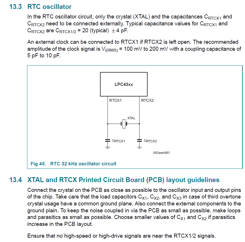

jeremyzhou
Hi uaz,
According to the datasheet, RTCX1 signal meets the amplitude's requirement, so please check the coupling capacitance by yourself.
Actually, I have no idea except for the aforementioned workaround, maybe you can share the schematic about the external oscillator connection.
